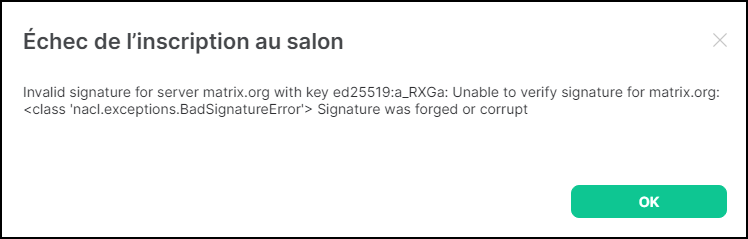

When I tried to join a room of LOCAL Matrix-Synapse from https://riot.im/app, I still get:
“Invalid signature for server matrix.org with key ed25519:a_RXGa: Unable to verify signature for matrix.org: <class ‘nacl.exceptions.BadSignatureError’> Signature was forged or corrupt”

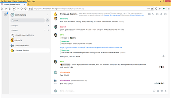

But I can join #synapse:matrix.org

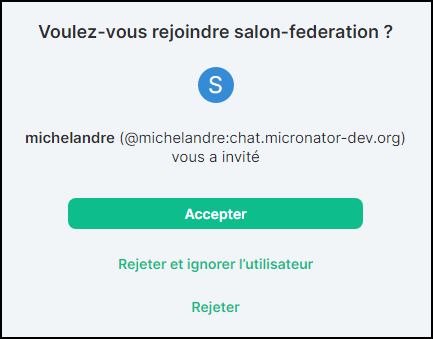

From my site, if I invite @michelandre:matrix.org
he receives the invitation.
When he clicks to respond:
If he clicks again:
In .well-known I tried 8448, 443 and nothing: same problem.

I just received an answer from GitHub - matrix-org/synapse: Synapse: Matrix homeserver written in Python/Twisted. forum which is very interesting.
@micronator: If you’re the same person that asked this question in #synapse, then your logs showed that something upstream of your server (Apache, presumably, or possibly Cloudflare) was replacing
%40
with@
in the request URI of incoming requests (and%3A
with:
), hence invalidating the signature made by the sending server.
Because I even tried with both NoDecode
and nocanon
, now I suspect Cloudflare…
