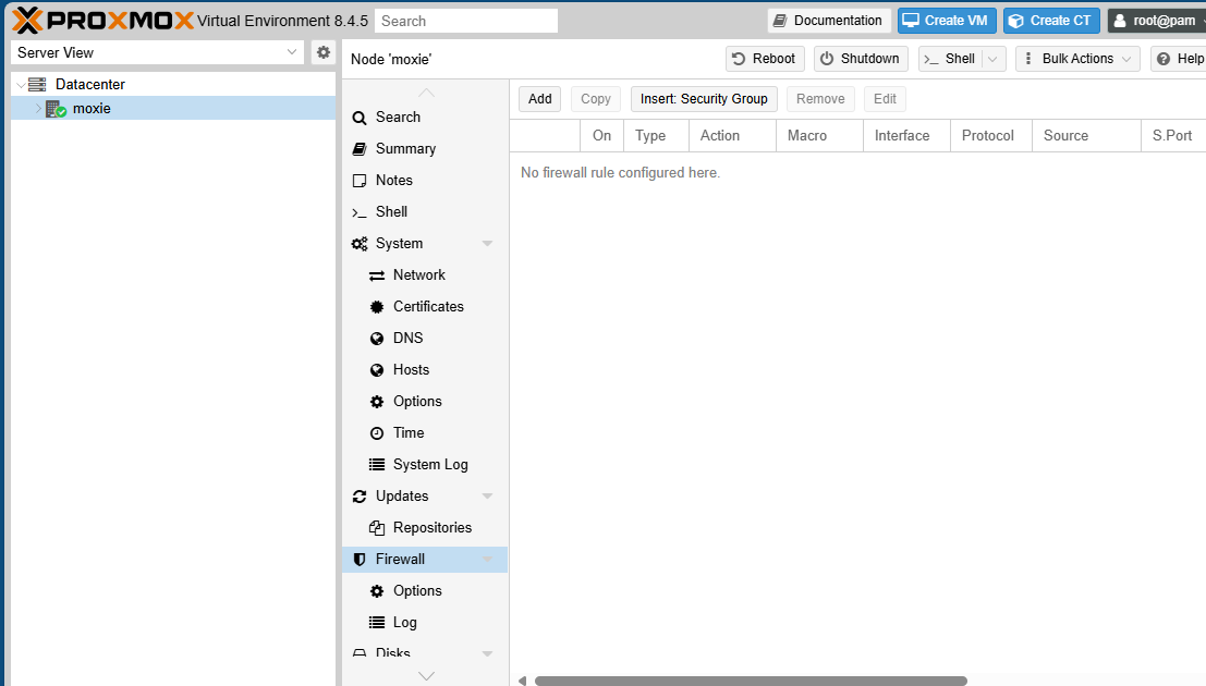

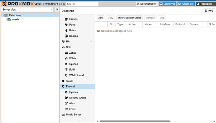

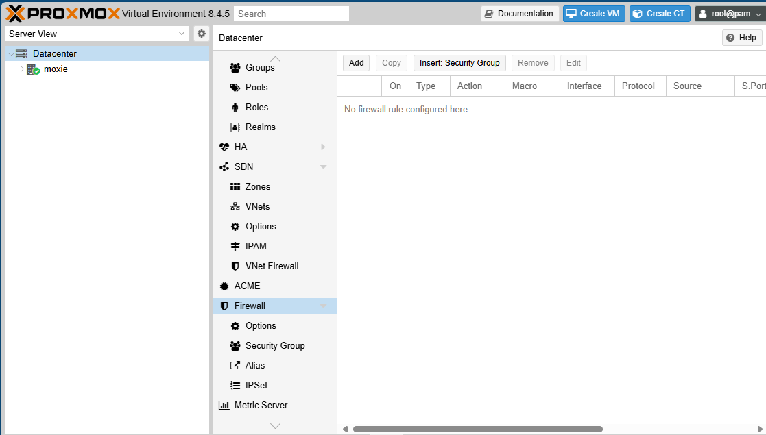

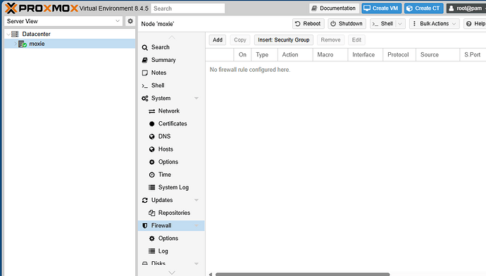

Are the virtual network devices ok and the fitewall disabled?
No firewall at datacenter or node (and there is only one node)

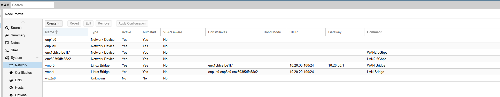

Here is network config. I can log into both the LAN IP for Proxmox on of 10.20.20.100:8006 and the WAN IP of Proxox at 10.20.30.100:8006. The LAN IP of the Xfinity router is 10.20.30.1, and the WAN port of Nethsecurity is 10.20.30.110 (DHCP reservation in the Xfinity router)
