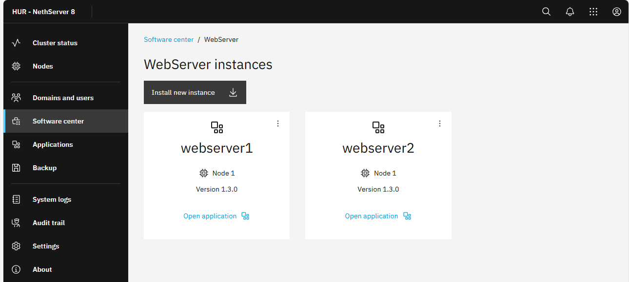

Do you have the latest webserver version installed?
Yes, I do:
