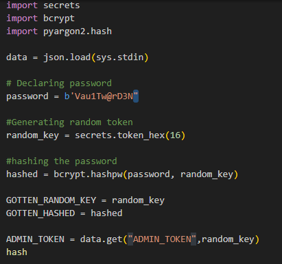

looks like i am only limited to using these two methods 2024-02-06T11:35:36+03:00 [1:vaultwarden2:vaultwarden-app] Please generate a secure Argon2 PHC string by using vaultwarden hash or argon2.
And mor einfo as documented here: Enabling admin page - vaultwarden - Gitlockr | A self hosted version of Gitea
PHC is found here: phc-string-format/phc-sf-spec.md at master · P-H-C/phc-string-format (github.com)
