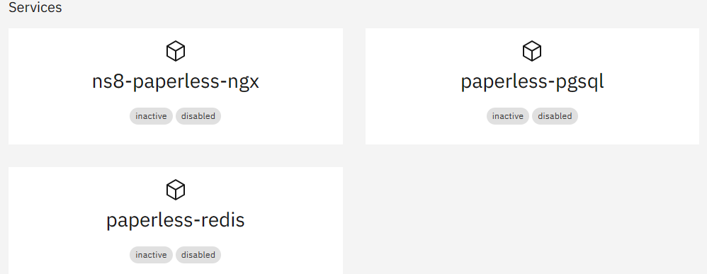

Can you help me debug and check why this services are not running

HEllo @stephdl and @davidep , now what seems to be the reason why the attached services are failing to start, because i think we should be having active
Normally no. Just the pod shoul be enabled because the attached service are binded to the service pod
A bind makes that when the pod start/stop the binded services do the same
so is it ok for the services to be in this state?
Services should be running at some point. For example in your configure-module action a step (usually I write a tiny shell script for it) executes:
if [[ -z $SOME_CHECK ]]; then
    # Enable and start the services the first time configure-module is executed
    systemctl --user enable --now first.service second.service third.service
else
    # Reload or Restart running services (containers)
    systemctl --user try-reload-or-restart first.service second.service third.service
fi
Yes the pod once you have triggered the configure-module must be enabled, the environment variable written to ~/.config/state/environment
