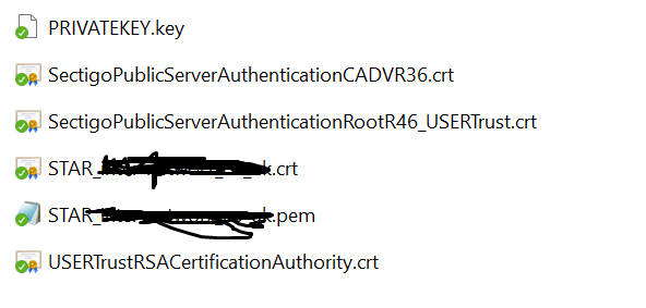

Hi all, i have just purchased a wildcard from commodo and im struggling to add it to Nethserver, i upload the key and the certificate and each time it says the key is wrong even though i have generated it and the csr, uploaded the csr to commodo and got sent the certificate.
i have tried renaming them, checking they are in PEM format.
what am i missing

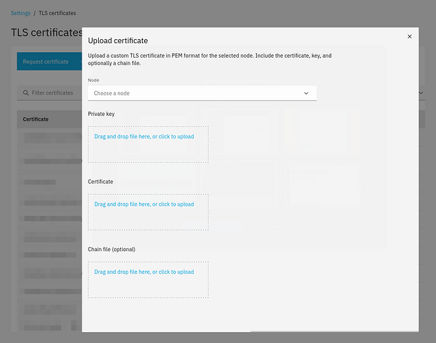

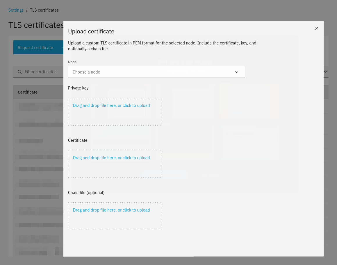

some certification authorities require also the upload of a chain file, a third field after the private key and the certificate. All three files must be PEM-encoded.
See also TLS certificates — NS8 documentation
Thanks, struggling as whatever i try it doesnt like it.
