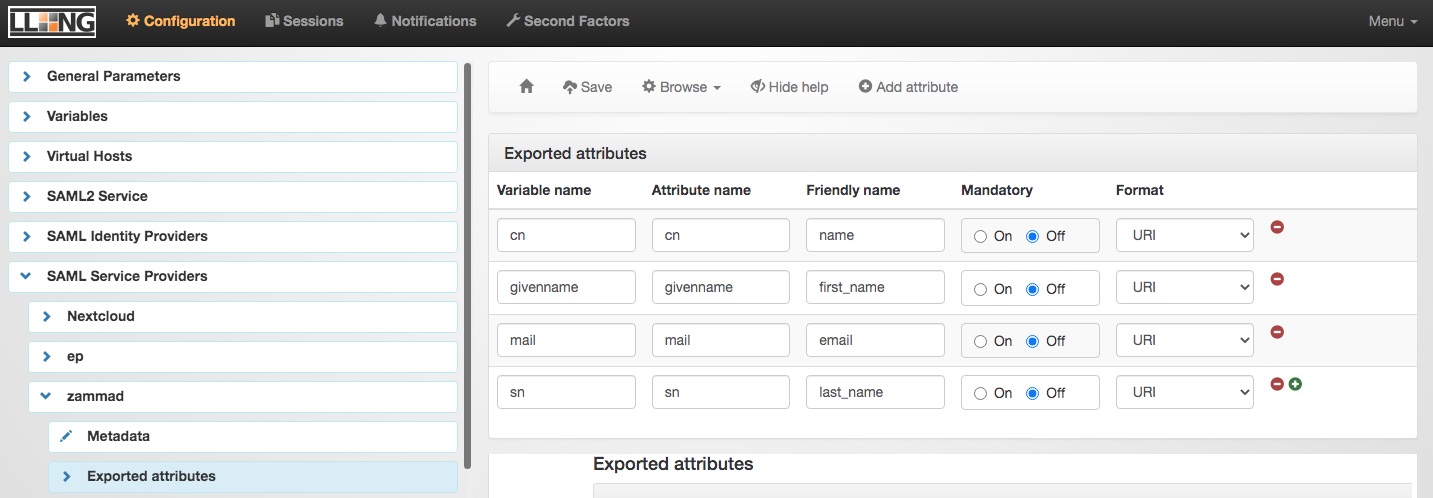

ok zammed simply click the gear in bottom left then go to security and select third party applications enable Automatic account link on initial logon
then enable saml
settings are
IDP SSO Target URL=https://auth.domain.com/saml/singleSignOn
IDP Certificate= the public cert under signature in lldapmanager
leave the next field blank
Name Identifier Format=urn:oasis:names:tc:SAML:1.1:nameid-format:emailAddress
In the manager create the sp
for metadata url https://zammad.domain.com/auth/saml/metadata and load
under exported attributes see bellow
Under Authenticated Response chose email
and make the following changes under ldap exported attributes
obviously some of the attributes dont apply yet to the current config(im working on mapping other attributes)

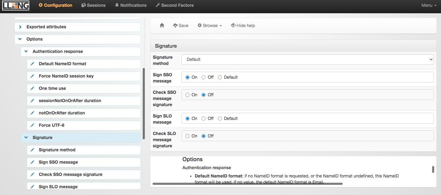

Update:
Ok ive got signing and encryption working but not checking of the signing see bellow

under Signatures and encryption offered
enable the first 4 options
under Signatures and encryption required
enable the first 3 options
under General
Enable both options
and for now (until i can figure out how to pass the certs without giving the private key)
under Service Provider Data
select windows
and enter the public and private key from encryption on lldpng manager
and on the manager under nextcloud
set Authentication response to windows
under signature enable all
under security
Encryption mode set to assertion
and set Enable use of IDP initiated URL to enable
and Authentication level to 1
reload the metadata and save.
signing both log on and off works and passes checks and encryption works
