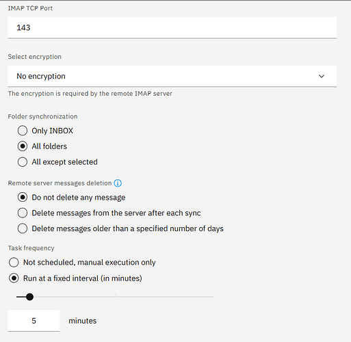

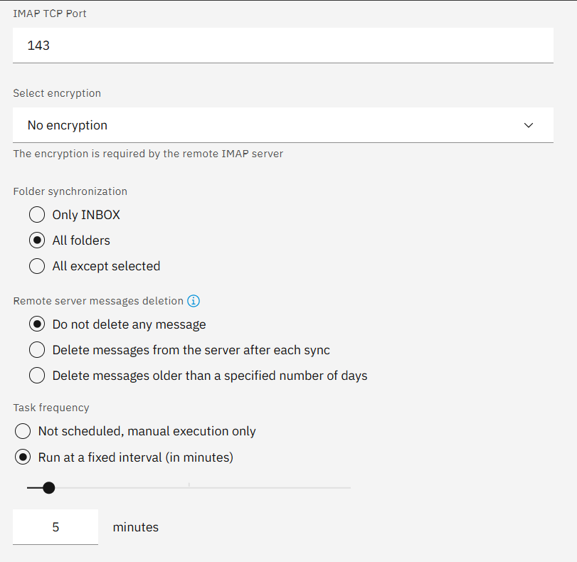

Imapsync does not start synchronization
NethServer Version: NS8
Module: imapsync on Node15
User mailbox (ken) 19GB
After adding several imapsync tasks, other users’ mailboxes stopped synchronizing. User ken’s mailbox downloaded only up to 8GB. I deleted the user ken’s task and added it again, but there was no change. Synchronization does not start.
api-cli run module/imapsync2/start-task --data …

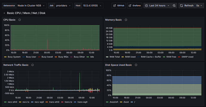

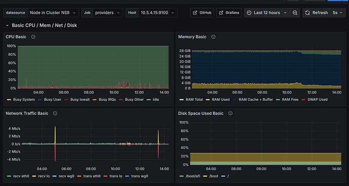

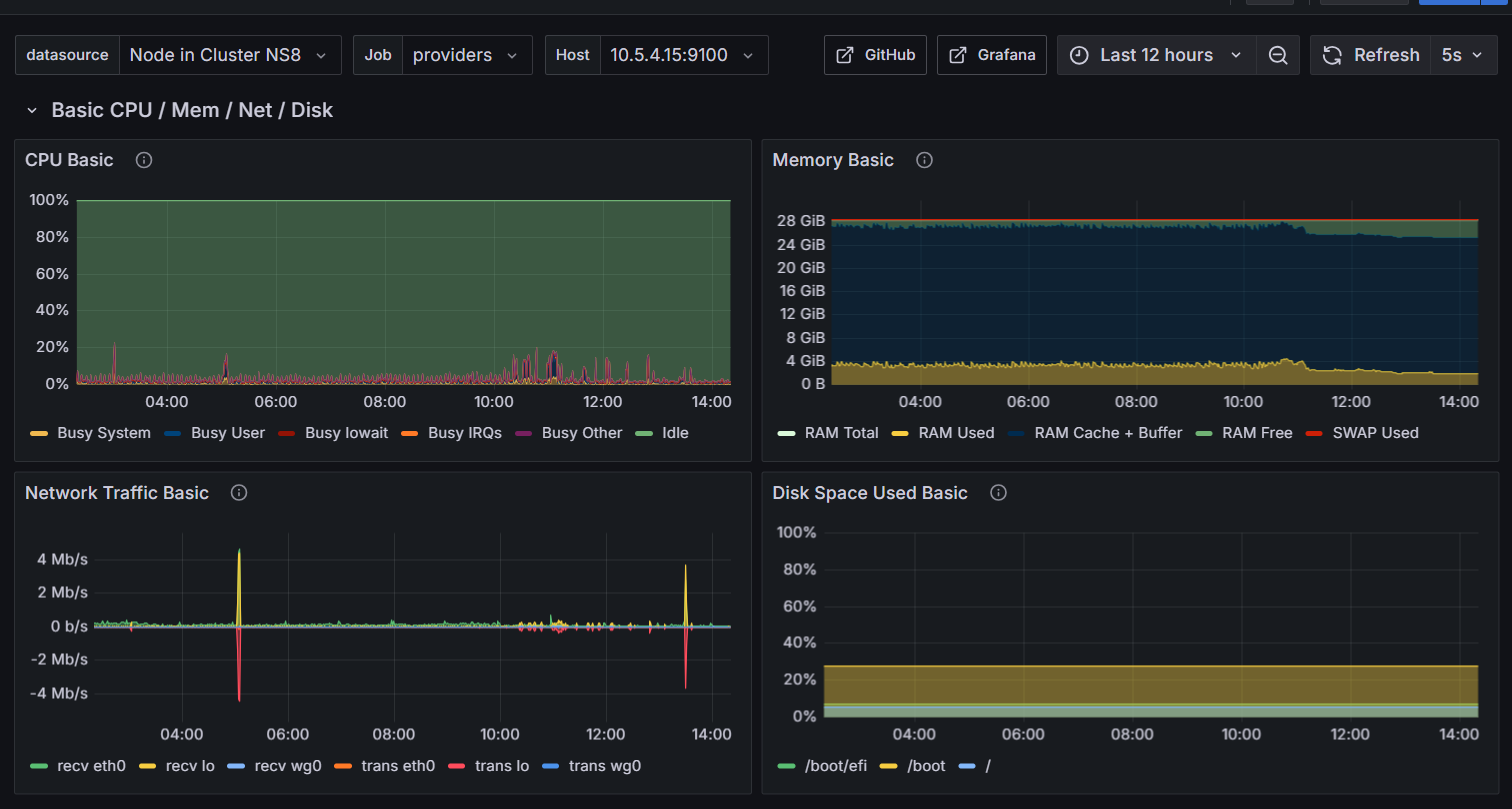

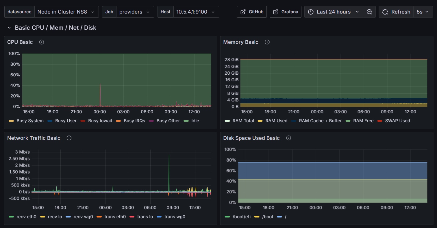

Could it be that the disk is full?
It seems like there is still some free space.
Leader Node1 free 300GB
Node15 (mail2, imapsync2) free 1.4TB

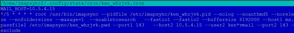

Command line used, run by perl:
/usr/bin/imapsync --pidfile /etc/imapsync/ken_whzjvk.pid --nolog --noauthmd5 --noreleasecheck --allowsizemismatch --skipsize --nofoldersizes --maxage=1     --fastio1 --fastio2 --buffersize 8192000 --host1 mx.mx.domain.com --user1 ken@mx.domain.com --passfile1 /etc/imapsync/ken_whzjvk.pwd --port1 143   --host2 10.5.4.15 --user2 ken*vmail --port2 143 --tls2 --passfile2 /etc/imapsync/vmail.pwd --exclude ^Public$|^Shared$

[root@mail _data] #du --max-depth=1 -hm
8089 ./ken

Are you using the “only INBOX” option in imapsync? See also Imapsync — NS8 documentation
This way only unread/unseen mails are transferred.
No. I use “All folders”

It seems that imapsync needs a special option --noabletosearch for syncing from mdaemon, see also https://imapsync.lamiral.info/FAQ.d/FAQ.MDaemon.txt
You could test it by using a custom script in imapsync, see also GitHub - NethServer/ns8-imapsync: Imapsync for NethServer 8
Here’s the imapsync command to put to a script and add the --noabletosearch option.
I’m migrating from mdaemon.
Added to cron but nothing changed :frowning:
From GitHub - NethServer/ns8-imapsync: Imapsync for NethServer 8 :
cron (e.g. ~imapsync1/.config/state/cron) This folder is designated for storing cron files, each of which should end its name with .custom, while adhering to the cron syntax.
Please change the filename to *.custom and remove the MAIL_HOST line, the file should just contain a cron line.
Did you already check the mdaemon logs? It would be interesting why it’s disconnecting…
