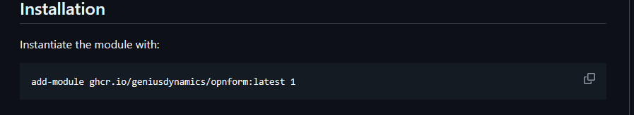

Is this edition on github the right one?
No, that will defintely dowload from the main branch, if you;re testing the non released updated version, the use :dev instead of :latest which will usually download the most recent release, or the main version
use
add-module ghcr.io/geniusdynamics/opnform:dev 1
to test the specific version we updated
