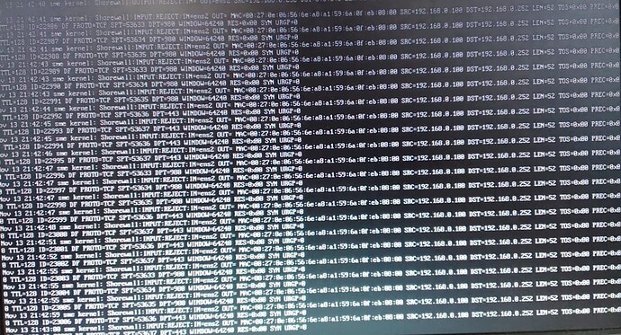

At the moment your connection from the other computer is dropped/rejected, the last lines of /var/log/firewall.log might show you a hint of the cause. A more verbose version can be obtained with shorewall dump, as it will dump a large list with the firewall configuration being applied. shorewall show can display useful info too.

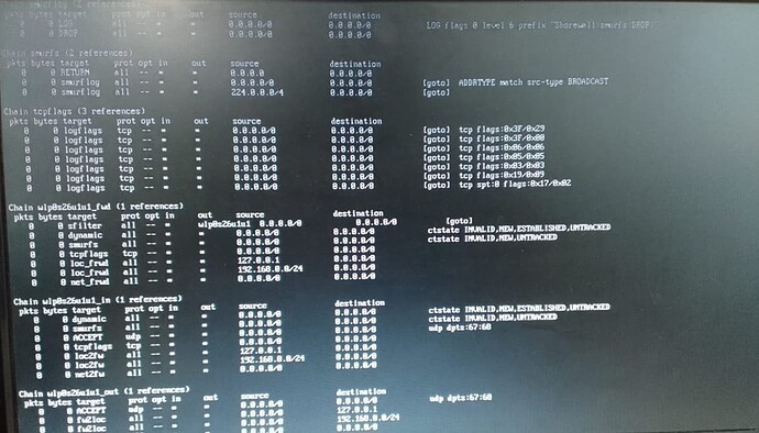

I’m confused because I don’t know when it’s a command argument or conversation, but to be more practical, my .sh contains “shorewall clear”, but it’s complicated
I did these commands without shorewall clear, so I don’t know if the result is different with shorewall clear
I don’t understand how everything before the power outage worked with a firewall and without this shorewall

sme kernel: Shorewall:INPUT:REJECT:IN=ens2 OUT=…
(FAQ 17) Why are these packets being Dropped/Rejected? How do I decode Shorewall log messages?
INPUT or FORWARD
The packet has a source IP address that isn’t in any of your defined zones (“shorewall[-lite] show zones” and look at the printed zone definitions) (…)

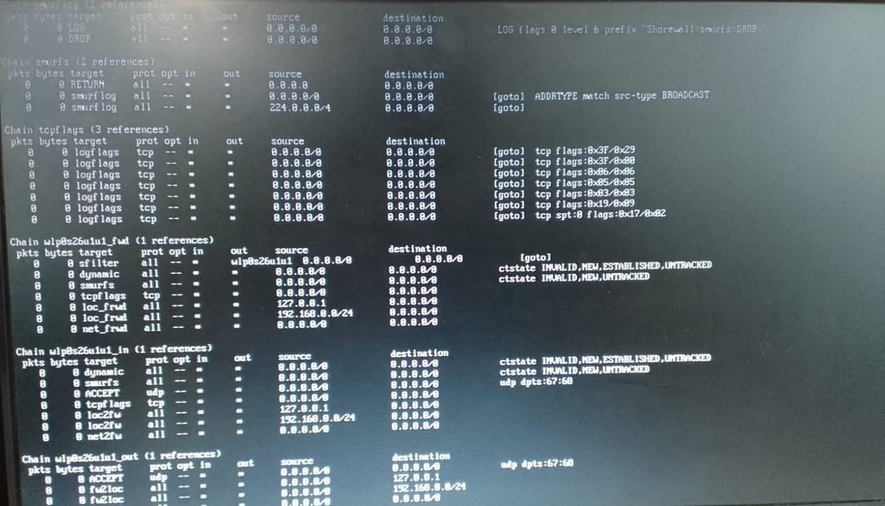

some of the photos (with incomplete information) show rules for a wireless interface but no mention of ens2.
