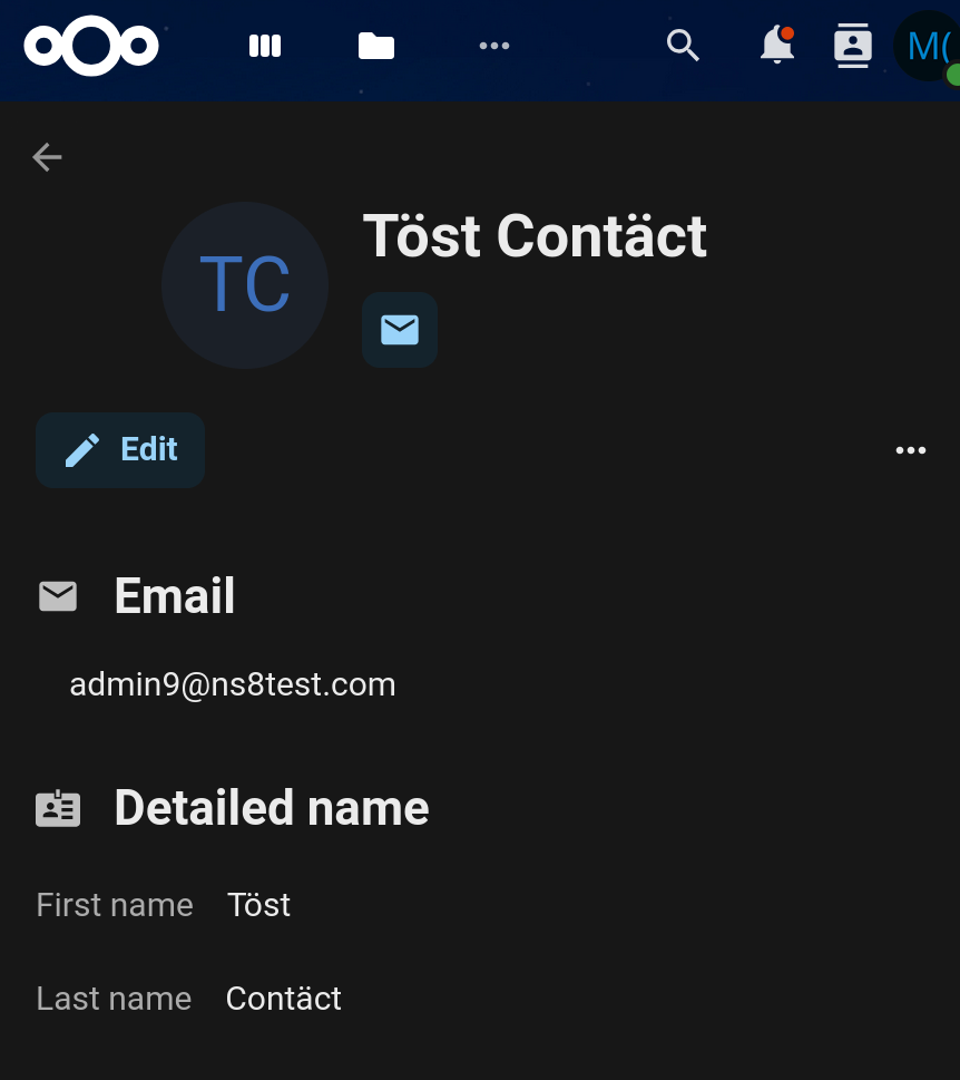

I tested it and it works when the file is encoded in UTF-8.
markus@asusminipc:~> file -i Downloads/testab1_shared_by_admin-2025-04-22.vcf
Downloads/testab1_shared_by_admin-2025-04-22.vcf: text/vcard; charset=utf-8
I think you can convert the files using iconv or for example Notepad++ in Windows, see also How to Convert Files to UTF-8 Encoding in Linux
