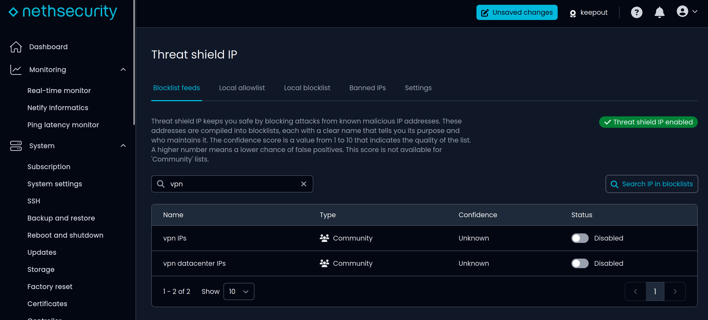

I found that it’s blocked by NethSecurity Threat shield IP, when the “vpn datacenter IPs” blocklist is enabled.
I don’t see the VPN datacenter IP in IP shield.
But when i disable the DNS shield it connects
Now added the NS8 subdomain to the whitelist, which seems to work
It should be listed:
I think you should add the stats.grafana.org domain instead.
found the VPN indeed. Looking on you mobile not always easy… :joy:
This was disabled in my config.
The DNS filter was the root cause.
Added stats.grafana.org
