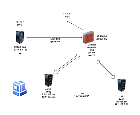

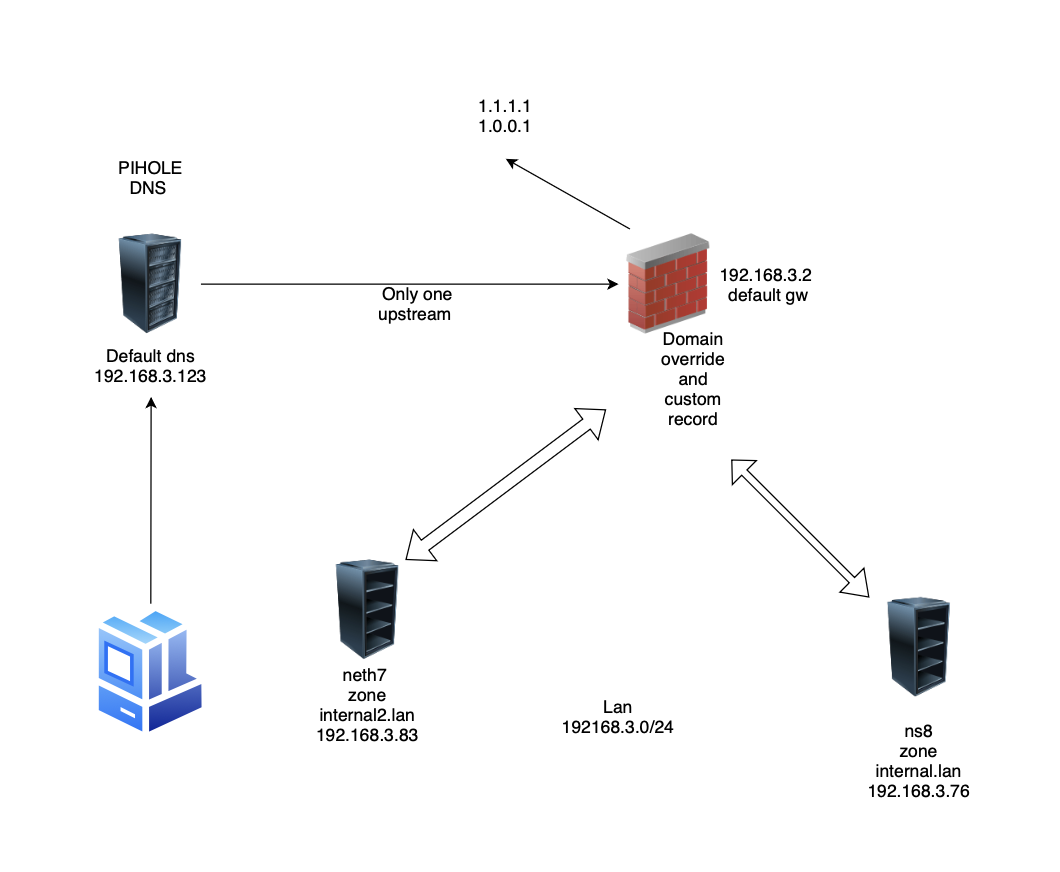

The AD servers are ns8 and neth7 . All hosts have as primary dos pihole which in turn has only an upstream des which is the pfsense, which in addition to other custom options that I have listed, forwards the Queries to the competent domains.

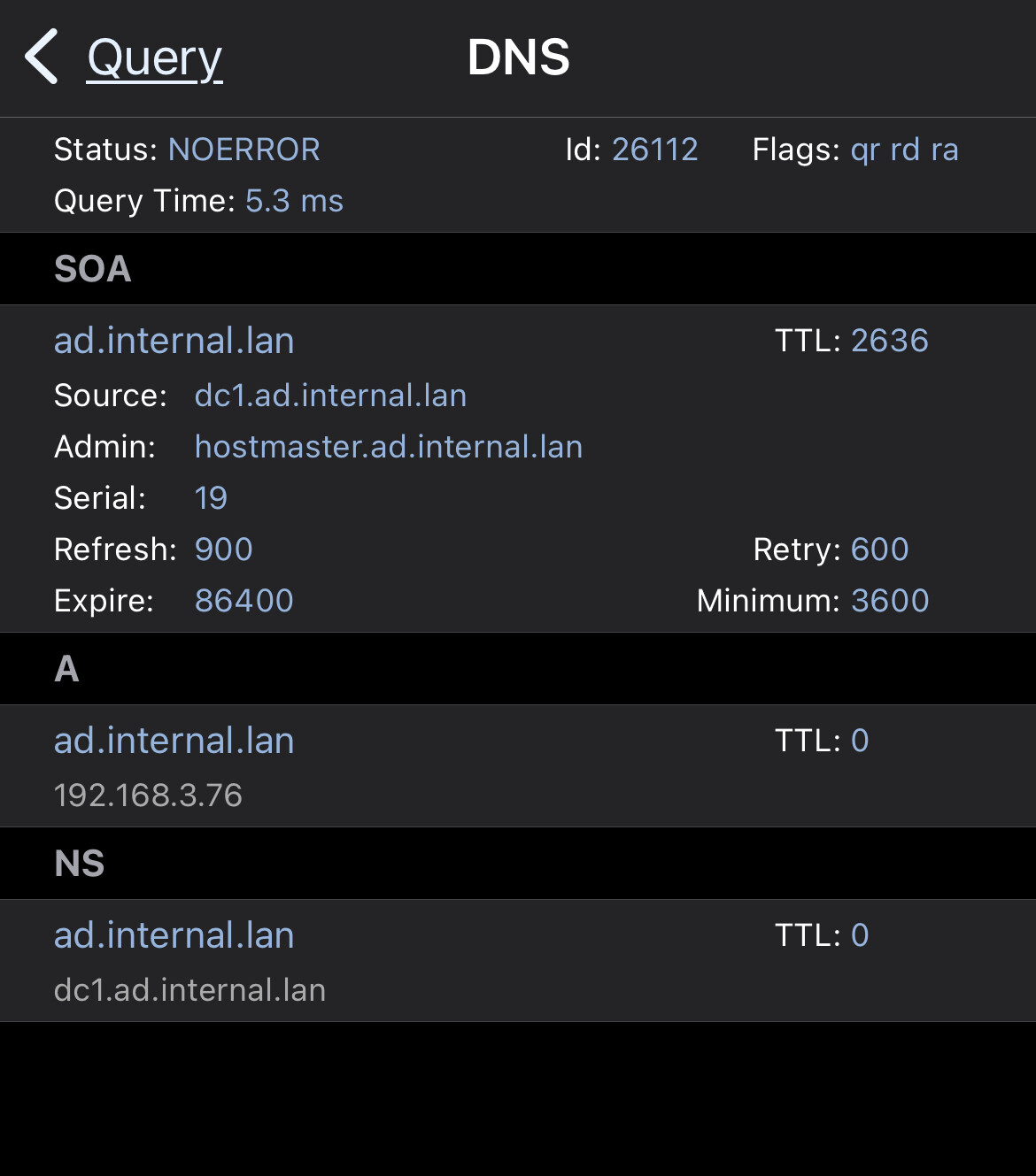

If I run a nslookup for the area ad.internal.lan :slight_smile:
Root@pi-hole:~# nslookup w10pro2.ad.internal.lan
Server:		 127.0.0.1
Address:	 127.0.0.1#53
Non-authoritative answer:
Address: 192.168.3.194

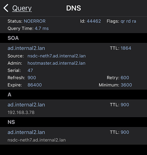

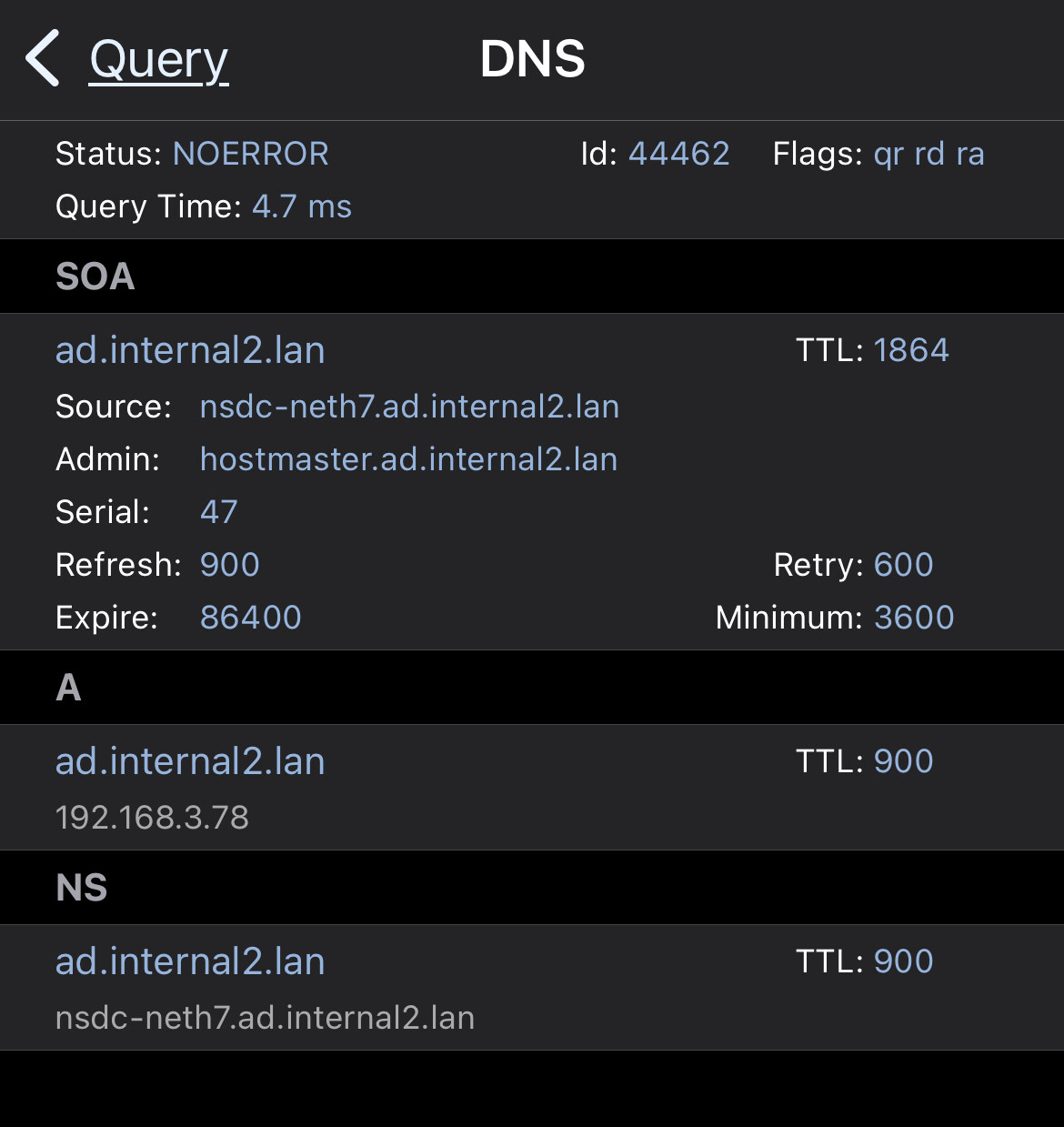

If I follow a Query for the internal2.lan (neth7) zone this happens :slight_smile:
Root@pi-hole:~# nslookup guacamole.internal2.lan
Server:		 127.0.0.1
Address: 192.168.3.197
** server can't find guacamole.internal2.lan: SERVFAIL
Solve the same name but from srv fail , due to a probable ttl0 in the answers of samba ???

Hi Mark, pihole as written before is the primary dns, and use as upstream pfsense. I have been trying to insert the conditional forward for the zones for a long time and it works regularly but with the exception that the mx records are not resolved by nethserver. Example if I enable for the internal.lan and internral2.lan zones the respective competence domains , the servfail error does not occur . But from any client if I query host -t mx internal2.lan the result is null , so no mx for the internal2.lan area . Reason why I created the custom on dnsresolv of pfense (unbounbd), the records of my interest. However, this problem that in the end is not really blocking, it alone with neth7 and not on ns8. I don’t understand why if I request the internal2.lan zone from pihole and therefore not directing it to the pfsense upstream, the mx record on neth7 is missing. The script that I showed you indeed the results it shows are the pihole queries that it sends to pfsense that responds correctly for the resolutions declared in the custom file. As you wrote, you want to try to perform tests, but my goal is to understand why neth7 or pfsense respond with servfail! Thank you as always for your availability.
Which DNS server are the NS7 and the NS8 are using?
If you use a DNS conditional forward for internal2.lan to NS7 and the NS7 upstream DNS is an external one and not the pfsense, then you get no result for “internal2.lan” because the external DNS doesn’t provide the MX record for internal2.lan and NS7/NS8 don’t provide MX records by default.
Hi , As for neth7 I use 1.1.1.1 but I think I also tried with pihole (the default 192168.3.123 for everyone that relaunches to pfsense ) Ns8 use :
[root@ns8 ~]# cat /etc/resolv.conf
# Generated by NetworkManager
search internal
nameserver 192.168.3.123
