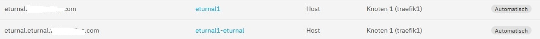

I have installed and configured an instance of eturnal. But there are two http routes visible.
1x eturnal.mydomain.com and 1x eturnal.eturnal.mydomain.com
Why is the second entry with the double eturnal in the fqdn?
See Eturnal Signaling server App - #12 by mrmarkuz
As a workaround until it’s fixed, you could remove the wrong route from traefik manually but configuring eturnal will add it again.
runagent -m traefik1 rm configs/eturnal1-eturnal.yml
Thanks, that worked. Am I correct in understanding that no ports need to be opened to the outside in the firewall? For example 3478.
