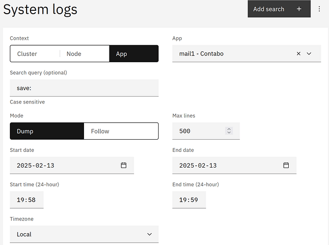

right, there comes no mail into the postbox of the user
nope, this was just a dummy, but the email adress in the script exist
Rspamd shows no errors, but i saw the mails from the account.
i changed the ip to the server name, but still no luck
this is the whole log from fetchmail, everything is quit with okay, i truly have no idea ![]()
