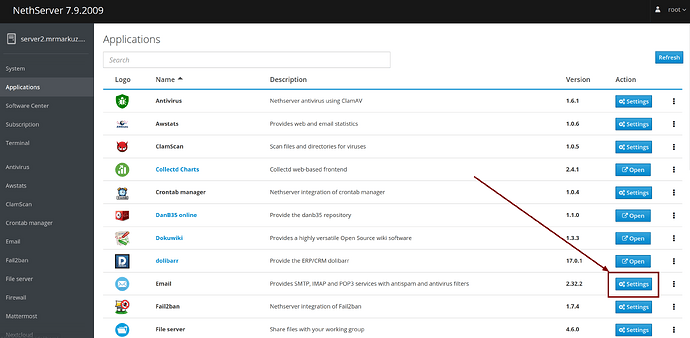

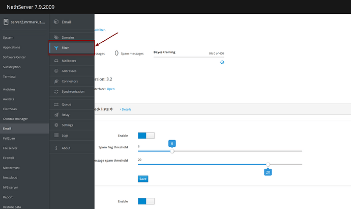

I think it’s better to disable the scanning for mails in the mail filter settings.
Go to the mail app settings:
Go to the filter settings:

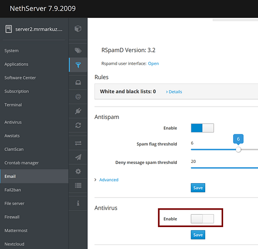

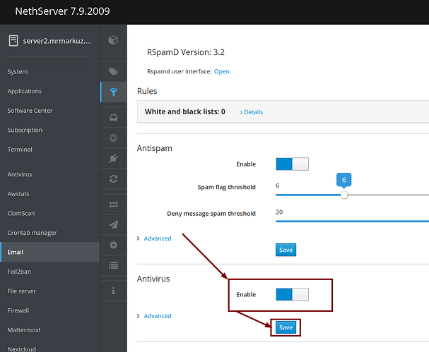

Disable antivirus and “Save”:
OK, I disabled as you suggested and I’m able to send and recieve as normal (….and breath again!)
