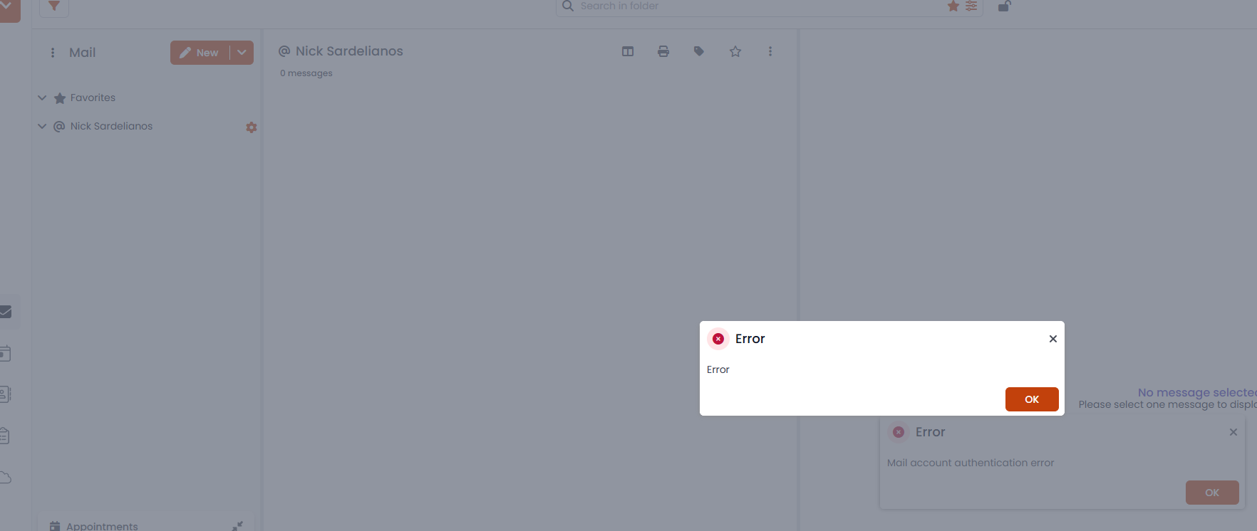

Just updated my webtop, and now it fails to log me in!
Initially it pops an “Error” dialog with text “error”, then behind it is another “Error” with dialog "Mail account authentication error’ (which is not true).

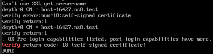

I’ll keep you posted. In the meantime, please check the IMAP server’s certificate to see if this could be your case, for example:
openssl s_client -connect 10.5.4.1:143 -starttls imap </dev/null | grep ^Verify

Thanks I will get back to you with what I found.
