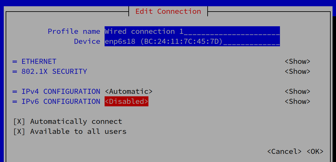

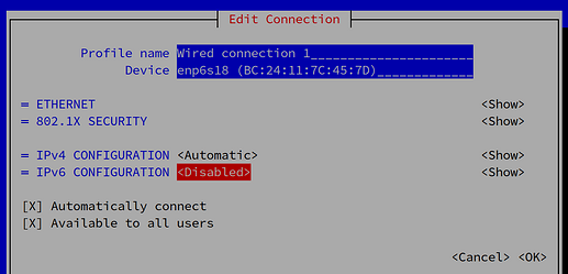

This disables IPv6 completely. I meant to just remove it from the network like disabling the configuration in nmtui by setting it to something else than “Automatic”.

Can you please explain what has been ‘done’, and how it solved your issue?
Excuse me. I set IPV6 CONFIGURATION = disabled with nmtui. Now mail excape in IPV4
